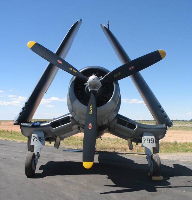

    Any symmetrical wing will fly inverted, such as the wings on an aerobatic plane, but commercial jets use asymmetrical wings for greater lift. An asymmetrical wing CAN fly inverted, but it requires a greater angle of attack and substantially increases drag. If all other systems in questions are operating nominally, my concern would be the negative-G rating of the wing. Anything more could cause a wing to fold like an F4U Corsair...
