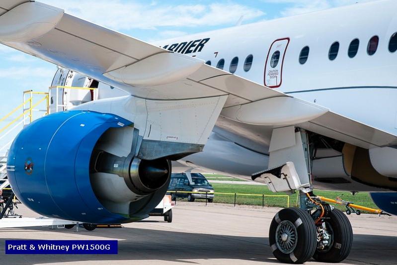

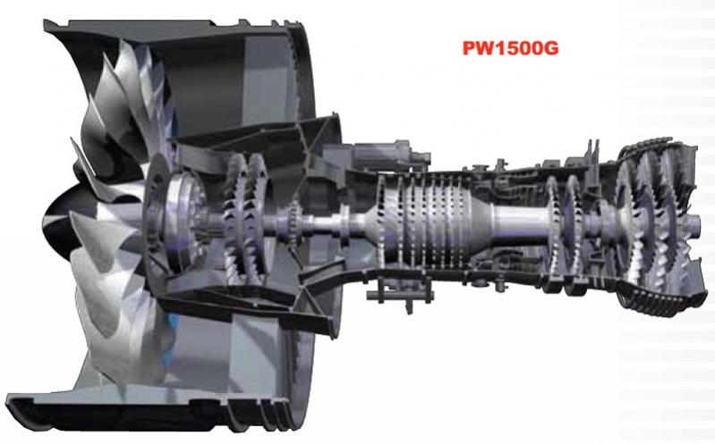

    PW1500G geared-turbofan engine failure
    According to Greg Hayes, CFO of parent company United Technologies Corp., Pratt & Whitney has made a preliminary determination of the root cause of the PW1500G geared-turbofan engine failure during ground tests on a CSeries and is working with Bombardier on a plan to resume testing in the next few weeks hoping there will not be significant impact on the testing schedule.
    As is alredy known, the uncontained failure occurred May 29, at Mirabel, near Montreal, during stationary ground maintenance testing of the first flight-test CSeries, aircraft FTV1. The incident damaged both the engine and the aircraft.
    All flights were stopped, but ground testing were continued on aircraft FTV-2, FTV-3 and FTV-4. The engine was soon shipped to Pratt’s Connecticut plant for tear-down and inspection.
    Any suspected cause was not detailed, but happening does not relate to anything to do with the fan drive gearbox!! As it seems now, it is something much simpler than that. Some unconfirmed reports have tied the incident to the engine’s oil system because the oil pump on this engine was changed prior the accident.
    There is a strong belief at P&W, they do understand of what has occurred and if they are really on the right track in their thinking, it seems defect can be rectified quickly.
    Bombardier, meanwhile, has said the aircraft is quite repairable. FTV1 is the envelope-expansion, handling-qualities and engine test aircraft, but FTV2 is fully instrumented as a backup.
    The manufacturer said it still plans to begin deliveries of the initial 110-seat CS100 variant in the second half of 2015, already a slip of more than 18 months from the original schedule.
    Hopefully, final results of investigation will show that the problem was not caused by any (at least not big) design lapse, but rather of poor quality built-in part or failure during assembly after changing the oil pump. On the other hand it is quite possible that a mechanical problem arose due to improper operation of the electrical system of control, regulation and measurement on the engine.

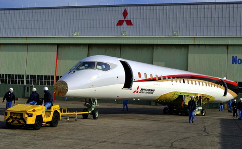

    In the shadow of the aforementioned events, Pratt & Whitney has delivered the first PW1200G geared turbofan engine to Mitsubishi Aircraft Corp., for installation on its MRJ.
    The Mitsubishi Regional Jet (MRJ) is a regional passenger jet aircraft seating 70–90 passengers.
    Seven test aircraft will make up the MRJ program. The MRJ’s first flight is targeted for the second quarter of 2015. First delivery is slated for the second quarter of 2017.
    The MRJ GTF engine delivery comes shortly after P&W delivered the first two PW1100G-JM engines for Airbus A320neo.

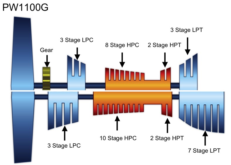

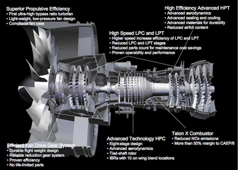

    LPT failed on PW1500G
    Investment bank UBS reports, citing Bombardier, that the low pressure turbine failed in the Pratt & Whitney Geared Turbo Fan engine PW1500G, on Bombardier’s CSeries prototype FTV-1.
    BBD confirmed that recent PW1500G engine´s failure was in the LPT and that the airframe (FTV1) was damaged in the incident, but downplayed the impact to the program schedule. While root cause analysis is ongoing, BBD emphasized that the failure has nothing to do with the gearbox, and also suggested that a manufacturing defect, rather than a design flaw, may have been the cause. The subject engine was known to have problems with the oil pump, and BBD had considered sending it back to Pratt prior to incident. Instead, engine was repaired at BBD and the failure occurred during subsequent ground-testing. Root cause could be expected by the end of week.
    Some rumors coming out of P&W’s Connecticut plant, where the damaged engine has been sent for tear down, say it was an oil problem in the LPT, that drives both, LPC and geared fan.
    FTV 1 was equipped with prototype engines, and that the production engines are first installed on FTV 4, the airplane that is designated to validate engine performance.

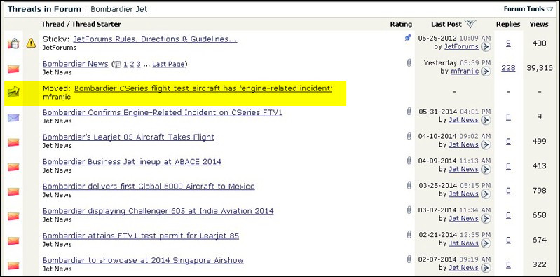

    I stripped the posts above from the Bombardier News thread because the incident should have a dedicated thread. I've also placed this in the General Discussion forum for awhile.
    Thanks!
    Carl
