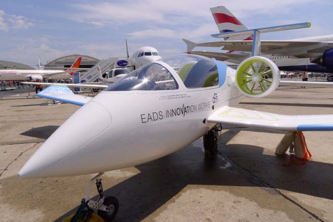

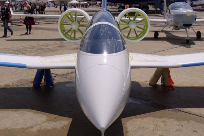

    The two-seat E-Fan features a pair of electric motors with a combined output of 60 kW (80 hp) driving variable pitch ducted fans to reduce noise and increase safety. Total static engine thrust is about 1.5 kN (337 pounds). The energy to power these motors comes from two multi-cell lithium ion polymer battery packs located in the wings which can power the E-Fan for up to 60 minutes of conventional flight at 110 mph, or 30 minutes of acrobatic maneuvers.

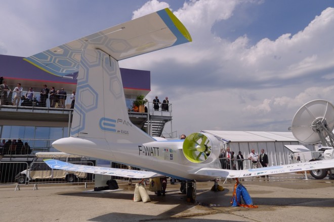

  2. Unlike most electric planes, which mimic conventionally-powered craft or are in fact converted airframes, the E-Fan design was engineered from the ground up. “I designed the original structure of the aircraft from scratch and did the first calculations before approaching EADS and ACS’ owners,” says Esteyne, technical director at ACS.
    “The lowest possible airframe weight is of critical importance for an all-electric aircraft,” says Esteyne. “And using carbon fiber composites was an obvious choice because of its better strength-to-weight ratio compared to aluminum alloys.” The entire fuselage, including the fin and empennage, as well as the wings and main spar were made from composites resulting in a total weight of just 1212 pounds. The length of the aircraft is 6.7 meters (21.98 feet) with a wingspan of 9.5 meters (31.17 feet).
