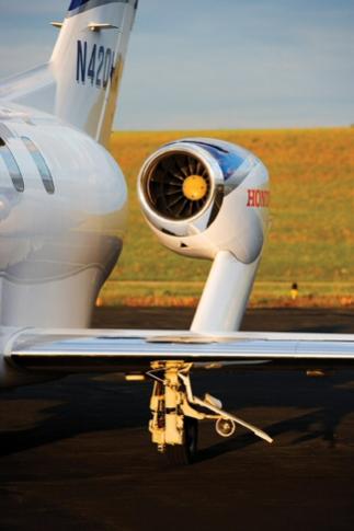

    That nacelle offset could be just to simplify the engine mount frame? What puzzles me is the distance of the nacelle off the wing. Does that have anything to do with the stability issue?

    I talked with a Honda engineer at the NBAA show and as I speculated, the pylon is offset to compensate for torque. The offset configuration provides two attachment points on the side of the engine; both high & low, granting a more secure engine mount in contrast to attaching directly to the bottom of the engine nacelle.
    I believe the height of the engine is two-fold; it places the thrust line on the same plane with the fuselage, thereby reducing pitch tendencies with changes in power, but also to reduce laminar interference above the wing. The intake of the engine is creating a large vacuum which could be disruptive to the negative pressure above the wing if mounted too closely. By the way, the image you attached above was taken at Honda's display at the NBAA. It was a nearly half scale model that was so realistic, even the turbofan blades were spinning.

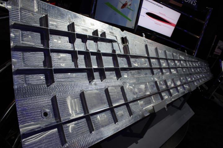

    Getting back on thread subject, Honda is going to extremes to achieve increased fuel efficiency by reducing drag. For example, the upper and lower wing skins are machined from bar-stock aluminum to remove the rivet-head imperfections normally found on the surface of a sheeted wing. The result is a super-smooth skin that is so thin, it is nearly see-thru. It's so light it can be lifted with your fingertips. This pic was taken at the NBAA show. It is the inside of the upper skin. I can't imagine loading a block of aluminum this size into into a three or five-axis milling machine...

    Good Lord Carl, that wing skin is amazing!
