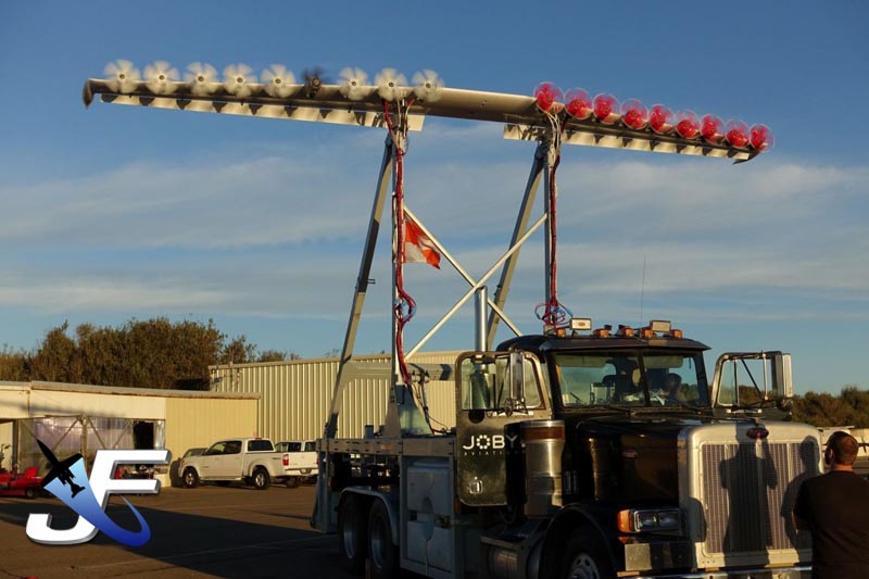

  5. The current test mule is a 31 foot wing with 18 electric motors mounted aboard the bed of a Peterbuilt truck for testing at Edwards Airforce Base, where it’ll be driven at various speeds to collect data on lift and drag coefficients. Once sufficient information is obtained, the plan is to mount the wing and engines to a Tecnam P2006T as a test bed to compare performance figures with traditional light aircraft.
