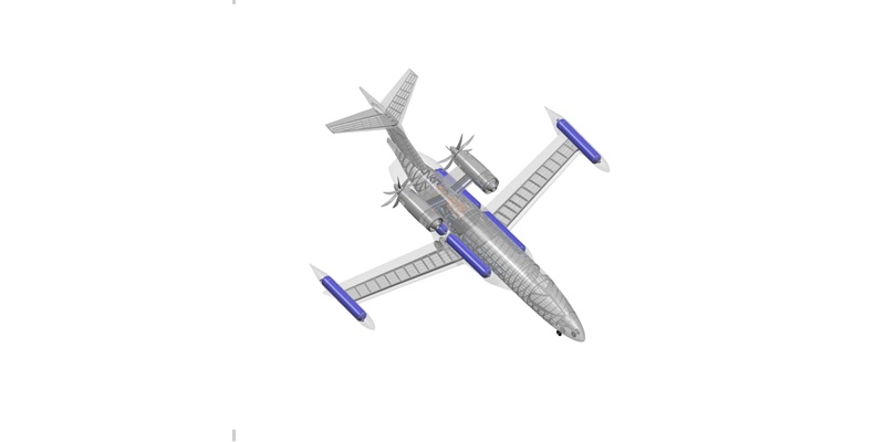

  3. Earlier designs with ducted-type architecture for the engines have now been replaced by rear-mounted pusher prop design. The aft-mounted pusher-prop design is expected to be operated on gaseous hydrogen commencing at around 700 bar in externally mounted tanks on top of the aircrafts' wingtips. Beyond Aero suggested that this arrangement will reduce complexity when refueling at airports and provide natural ventilation.
