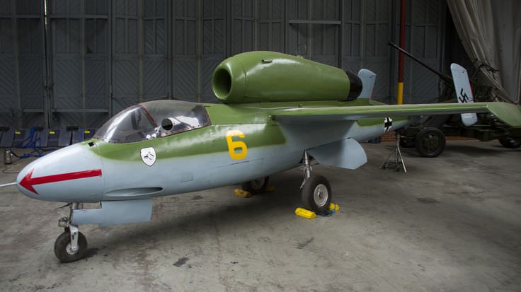

    Why does this design looks familiar to me ?
    WW II fighter plane Heinkel He-162 Salamander

    You are right... some resemblance there.

    This little plywood fighter came far to late. At this state of the war it was totally useless. They had no more pilots and no resources. In the late sixties, we had an old WW II pilot in our glider club, who had flown this plane and the Me-163 as a young officer. He liked both planes from the pilots point of view but as warplanes they had very limited effect.
