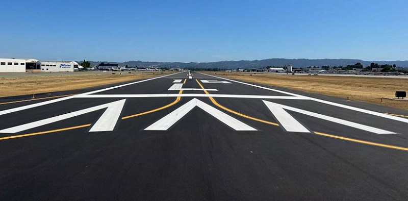

    Van Nuys airport short 4,000 ft runway 16L/34R has been reopened after it was under reconstruction the last several months ad cost around 13.1 million to execute. Another runways 16R/34L is expected to undergo rehab work too. This runway is an 8,000 ft long runway.

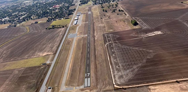

    The runway 17/35 at Oklahoma's Watonga Regional Airport was just rehabilitated at a cost of nearly 3 million dollars. It has now reopened to the public. It is a pretty short runway as well being only 4,001 feet long. Over a 5 month period the 2.8-million dollar works saw the runway brought back to mint-condition after it had not been resurfaced in 20 years. With the new works new LED lighting was also installed.
